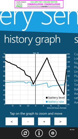

Thank you for posting this! I'm in the same boat as you, and have been wondering if I'm crazy. I switched from a 920 to the 1520 (international RM-937) a week ago, and on the first day I duplicated my 920's configuration on it exactly -- same apps, accounts, configuration, background tasks, etc. My configuration is eerily similar to yours, with the only difference being that I leave the glance screen set to always on (which surprisingly made less than a 10% daily difference on my 920.)
For the first two days, my 1520 only got 12 hours of battery life each day, and that was with my regular, everyday usage, without any gaming, video watching, tethering, nav, or anything else battery-intensive. I then tried a day with automatic brightness, sunlight readability off, the glance screen off, and email accounts set to only poll hourly, and it made no difference to the abysmal battery life.
Since then, I've tried removing chunks of background task-capable apps, thinking it's a buggy app molesting my battery or cpu for some reason. Yesterday I thought I had nabbed it -- the phone did great all day; the Battery Sense app had it at around -3% battery rate per hour all day, and the battery was at 50% at 10pm, 16 hours off the charger! I then charged it on my 920's qi charging pad overnight (neener, America!) and today, with the same configuration as yesterday, it's been sucking between -9-12% all day long, with no apps running and almost no usage by me. I got fed up with it around noon, uninstalled every single app and game on the phone except Battery Sense, rebooted it, and it continued its battery sucking all the same -- wtf, right?
I had to put it on a charger around 3:30, just so it wouldn't die on my commute home, but I've attached the Battery Sense graph showing yesterday and today's differences. I think I'm going to take it back to the store and exchange it tomorrow, in case it's a bad battery or cpu or cog or sprocket or something. Oh, and if it matters, it's been the same with both the 10517 and 10521 OS builds (developer preview program,) and all of the Nokia apps are up-to-date.
If anyone has any ideas, I'd love to hear them! This phone has been nothing but frustration for me so far, and makes me miss my 920 :( (The 920 went to the gf, and I'd have better luck prying a gun from zombie Charlton Heston's hands than getting it back from her...)

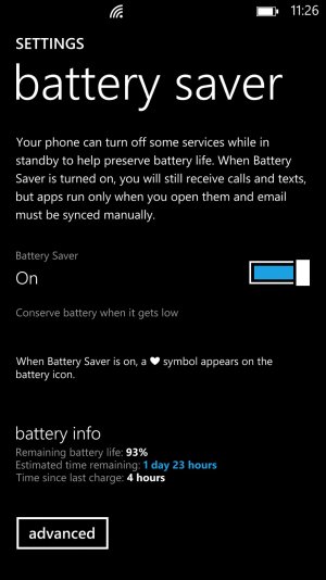

Interesting.. With all my original options back on (except I've set 3G to my highest connection) I only see 20 hours and 16 min remaining at 100% battery. My discharge rate is 4.93% an hour according to my battery app. Curious if there's something more than my weak LTE signal causing battery drain. Mind you I've only done one FULL discharge of my battery since having my 1520. So I don't know if that helps at all.
Two
days were spent with automatic brightness off and high brightness on, before switching to automatic; the 6" of high brightness was just too bright for me in a dark room, like when lying in bed. No significant battery difference with either setting, at least in the sense that I've never seen less than 48 hours estimated. Otherwise, I have wi-fi and location stuff on, glance screen set to Always On, Bluetooth occasionally on to use with my Jaybird ear buds, and with nine apps enabled for background tasks (one being the new Nokia Motion Monitor beta, as I mentioned.)
Granted, both 1520s have had the same loose sim card trays and iffy touchscreens, but those problems are trivial compared to the battery issue I was having. I'm hoping the Nokia firmware update fixes the touchscreen issue, if us international RM-937 people ever get it.
Overall, though, now that my battery life is proper, I LOVE this phone! :) There's no going back to a "small" 4.5-5" phone for me!

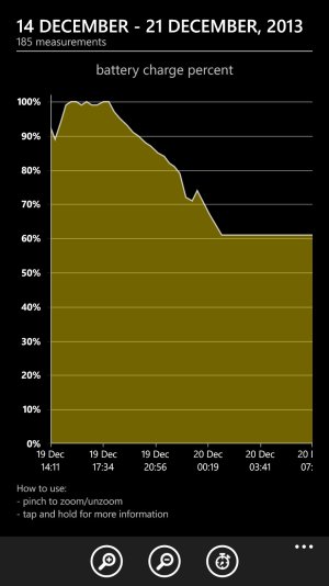

EDIT: Last night I drained my battery to zero. Plugged it back in, turned on airplane mode and left it to recharge in hopes to recalibrate it further. Now with airplane mode on I would expect maximum battery life. I checked the battery this morning and it still only showed 20 hrs remaining at 100% with airplane mode on.
Would a rogue app cause battery drain on airplane mode??
