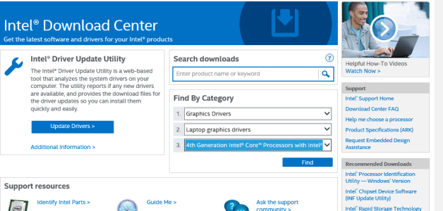

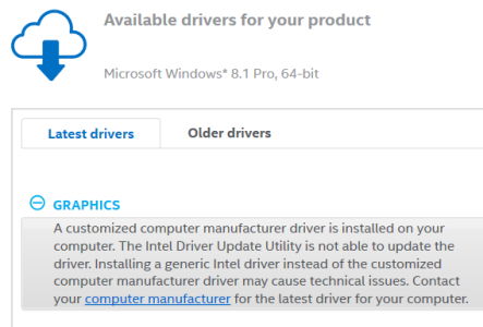

I am trying to do the exact same thing you did (on my Surface Pro 3) -- eliminate letterboxing effect and add in a custom resolution of 1440 x 960. I am stumped, as the Intel Driver Update Utility tells me this:
I don't want to break my Surface, but it appears that I will have to manually install the drivers for this chipset. Anyone know which Chipset comes in the latest version of the Surface Pro 3 ?

I'm not sure what version of Surface Pro 3 you have, I have the i7 so I download the HD Graphics 5000 one. But go here and select the right one for you and then download the zip file. You will then have to manually do the driver upgrade and manually browse to/select the graphics driver.
