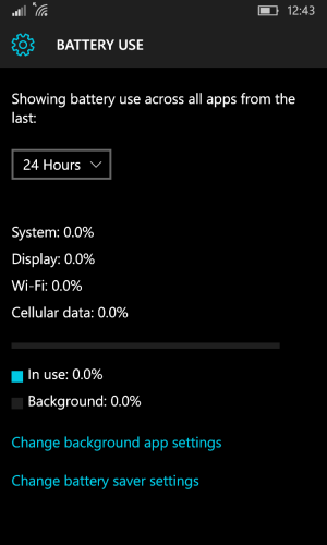

I really have almost nothing that good to say about 10549 on my Lumia 1020. A couple times a day I swear at it and think about going back to 8.1, then decide to stick it out hoping updates come quickly. After all, we have to be getting close to something stable if the 950 and 950 XL will ship in the next month or so. But I don't see it. Maybe it's specific to certain devices, but on the other hand, it's just too close to release for the kinds of things I'm seeing now.
For battery usage, I'm seeing maybe 6 to 8 hours at most. It just drains quickly no matter what. And I've yet to see anything useful from battery usage on the phone. This is what it always looks like:
