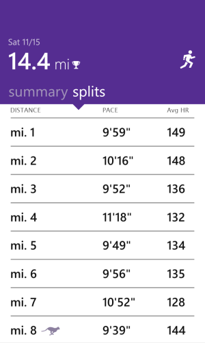

Did an early run today and the results, battery and GPS accuracy wise, is not good.
I turned on both at the same time at the same spot. Garmin got a GPS lock right away but Band took about a mile.
Its too cold for me so I stopped at 14 miles. I started with the Band at 100% charged. After about 2:22 hours running, the charge is down to 20% with GPS on. So I bet you it won't last another hr. This Band won't last 4 hours run.
Garmin recorded 14.12 miles, Band is 14.4 miles. The average and max hr is not good but I don't really expect either Band or Garmin to be accurate.
My average hr on Band is 137 while Garmin is 148. Acceptable for me.
So I might end up returning the band.

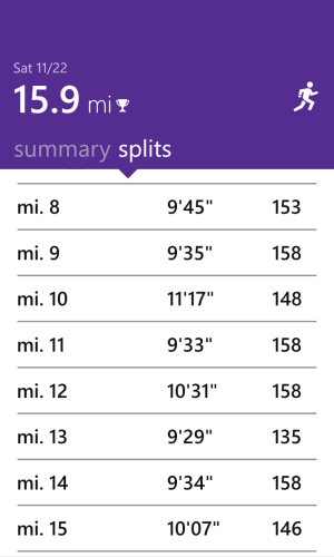

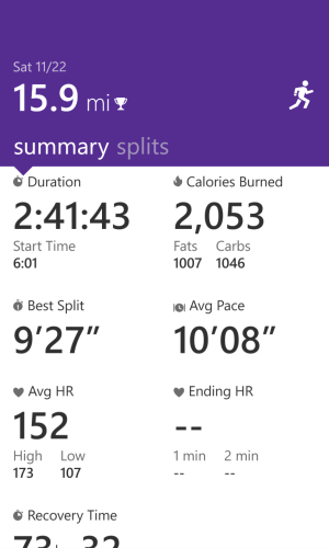

I did another run today and what surprised me is the battery.
I charged it for about two hours and it only charged to 80%. I turned it off before I slept.
I run early for about 16 miles. What's amazing is that when I put it back to charge, it got 40% left. That's right, 40%!
Last week I run 14 miles for 21/2 hours and got 20% left. Today my run is around 2:41 hr: min. I figured the battery is getting better after a few cycles? This is a slow relaxed run so it might actually last a marathon if it can last another 40 min.
I run it with Garmin 620 plus heart rate monitor. The distance is almost same.
And what's also amazing it that I looked at Garmin data and my heart is actually more accurate with Band.
With Garmin I had a HR of 80s running 9:30s at 11th mile. That is low.
So I think its a keeper. I just wish it has auto pause and lap pace. I also run it in the rain and it seems fine.
