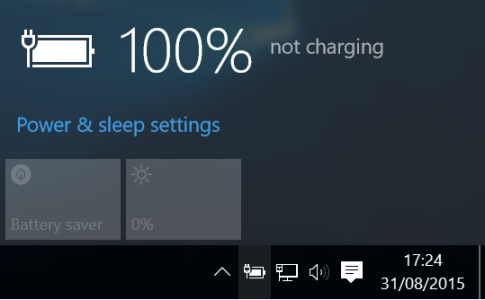

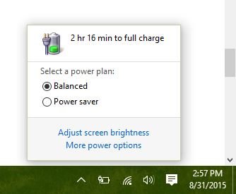

So without further delay, this little guide will change the battery fly out from:

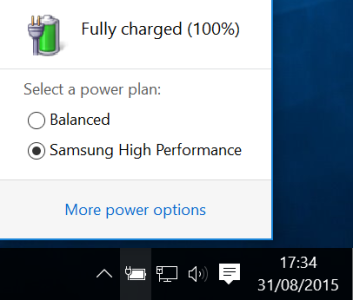

To this:
{NB: I have a Samsung 850 EVO SSD in my HP Probook 4730s hence why my selected power plan is showing as "Samsung High Performance"}.

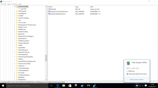

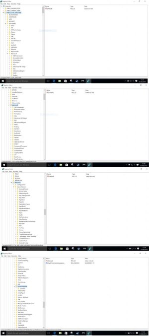

2) Navigate to HKEY_LOCAL_MACHINE\SOFTWARE\Microsoft\Windows\CurrentVersion\ImmersiveShell
    Edit: You will need to click on this image to zoom in for more detail.

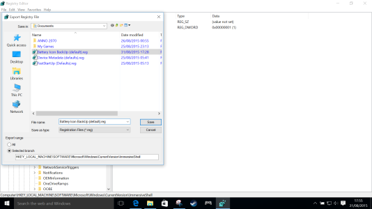

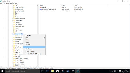

IMPORTANT STEP - BACK UP:
Right click on "Immersive shell", left click export, save as what ever you like

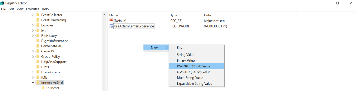

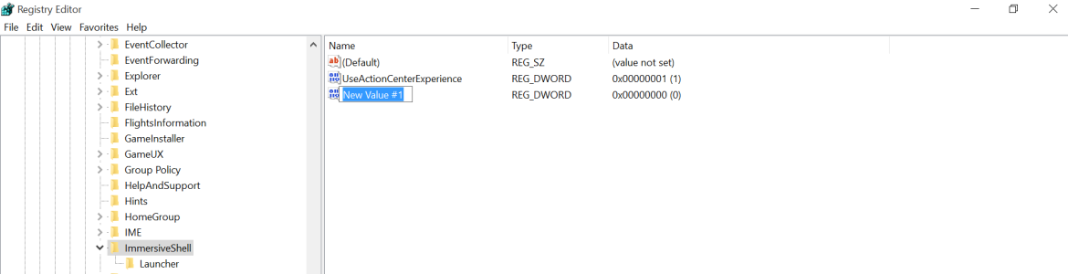

3) Create a new Dword Value (32 bit) via the right click context menu or you can use the "Edit" button then "New" on the toolbar at the top.

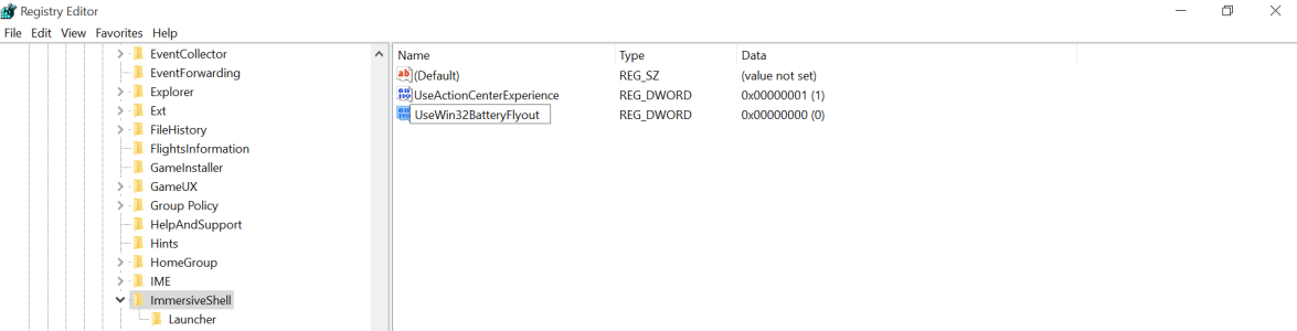

4) Type in "UseWin32BatteryFlyout" and press enter or left click anywhere in the whitespace of the registry editor. However if you have accidently left clicked elsewhere or pressed enter thus ending up a new value called "New Value #1". Not a problem you can right click on it and click rename - to rename it. Again alternatively you can use the "Edit" button then "Rename".
Or you could simply delete the newly created Dword Value and start again.

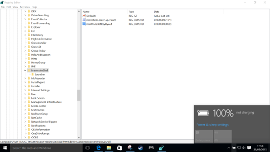

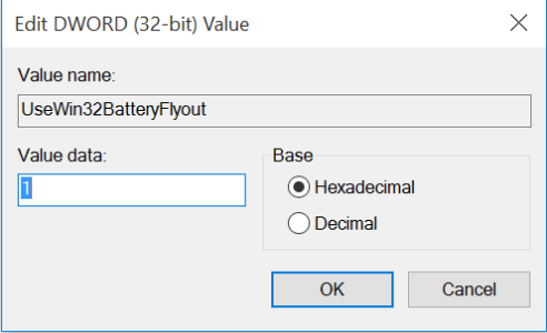

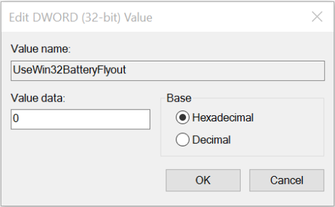

5) Double click on "UseWin32BatteryFlyout" and change the default value from 0 (being OFF or DISABLED)
to 1 (being ON or ENABLED).
6) There you have it:
To disable this tweak and go back to the default fly out style:
Simply change the value again as above [Step 5] but this time to 0.

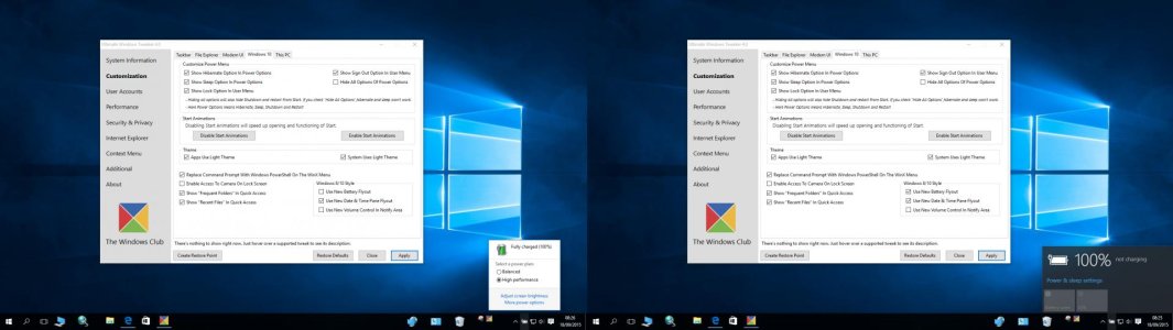

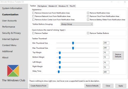

Found this nifty tool Ultimate Windows Tweaker, (beats creating a script :D) which you can use as quick toggle as opposed to using the registry editor as shown above.
Disclaimer: This tool has very advanced settings, only change them if you know what you are doing!
Otherwise you will completely mess up your install and may incur data loss
1) Extract and Start Ultimate Windows Tweaker - upon starting it will create a recovery point so you can revert back later if you go crazy with the other settings. However it may not undo all your changes.
2) Navigate to the Windows 10 Tab at the top
3) At the bottom right hand corner untick and click apply to get the old style - the task bar will flicker and you may get a notification about a change. However if you want to re-enable, tick the box again and click apply again the taskbar will flicker.
Lastly it will prompt you to restart once you exit the tool, you can restart if you wish (unless you changed other settings which do require a restart to take affect then you will need to restart)

Instead of editing my post, thought I'd bump this thread so you guys get notifications (if your subscribed). I stumbled upon this little nifty tweaking tool. Be warned though some of the options are for advanced users however it does include a checkbox toggle for the battery flyout and volume mixer (and much more).
Ultimate Windows Tweaker 4 for Windows 10
It's fairly light weight, no install needed and it auto creates a system restore point at first start up so providing you don't go overly crazy you can revert back.
