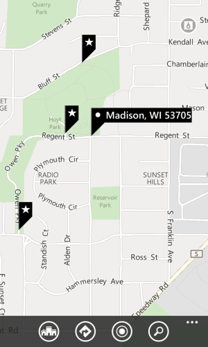

Open Microsoft Maps app, and tap the place on the map where you would like one of your location reminders. If you didn't get it exactly where you want it with your tap, you can drag it to the exact place you want it to be centered. In this screenshot I have three already saved locations marked with a star, and one with a flag that I am preparing to save after moving it where I want it. It should look like this on the screen:

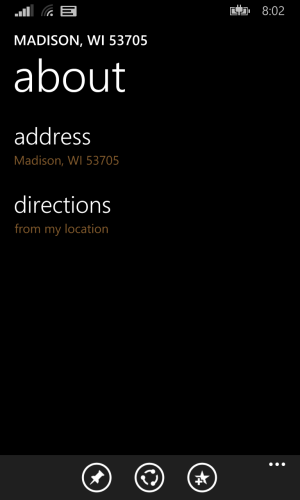

Once you have it there, tap the dot, such as the one to the left of the M in Madison and you should bring up this screen:
From there, tap the star at the bottom right of the screen and you will bring up the dialog box to save this location as one of Cortana's favorites.

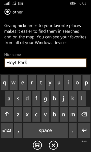

Here you have the option to define this as home, work, or other, and optionally to give it a nickname. If you happen to work at this large location, I would select the work option. Regardless of whether you pick home/work/other, you will want to give it a nickname. It will look like this:

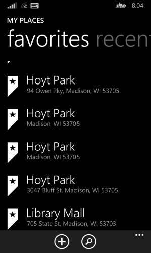

Once you do that, continue saving all possible entry and exit points with the exact same nickname and the same home/work/other designation. Once you have multiple locations saved, you can see them in Cortana when you go to her notebook by tapping on the three lines at the top right corner. It will look like this:

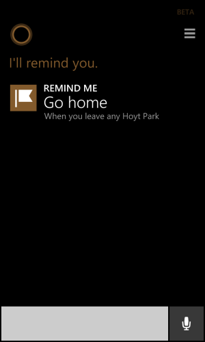

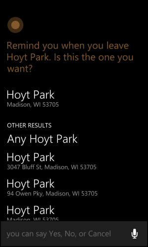

Now in this example I tell Cortana to remind me to go home when I leave Hoyt Park. Cortana gives me one of the saved locations as the first choice, but right below that she lets me select "Any Hoyt Park." By "Any Hoyt Park" she means "Any location saved with the name 'Hoyt Park'".
Select this "Any Hoyt Park" option.
Now geofencing will be triggered by any of my saved locations with this name.

I have a little bit of bad news when running this by the team.
Any ?Hoyt Park? (using the example above) doesn?t use the favorite locations you have saved. It would set up one bigger fence for ?Hoyt Park?.
If you used ?My Favorite Park? as the nick name, and tried ?Any My Favorite Park?, the reminder most likely won?t work, because there is no real park named ?My Favorite Park?.
When you select a particular favorite location from the list when setting the reminder, the radius is ~200 meters. When you select ?any?, the radius is determined by cloud and will most likely to be bigger.
