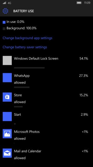

How was 14267.1004 on 950xl ?
Idle for 6 hours and only dropped by 3%. My only problem is that continuum doesn't work wirelessly in the last 4 builds.
