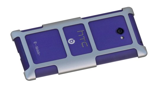

personally i think straight lines suit this phone more than rounded curves in your second design.
I agree. Im doing a bunch of designs right now and will start posting them soon. Thats the thing about this process is nobody needs to pick from 1 single design, but from many to suit there style.
Just a quick update. Two new designs. One thats a bit more "artistic" and one based off of user suggestions to match the phone design, and keep it minimulistic. Thanks guys! I think it turned out great!
*Please note!* These do not yet have the "textured grips" built into the sides. That will come later. I just wanted to show them off sooner rather then later ;)

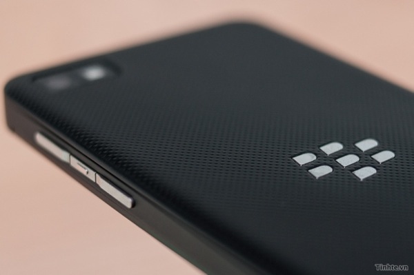

perhaps a textured suface option? not sure if possible with the 3d printing company you're using
blackberry 10 inspiration:
do you think your case will still work well as a metal option? i think the metal may not have the flex required to make it over the corner edges as a "snap-on" case
YES! The minimum wall thickness for the Silver is .8MM. I plan on using 1MM or 1.5MM wall thickness, so that will mean the silver will be flexible Also if you look at all the designs, there is a section close to each corner thats thin and long. This is designed to help the material flex to fit around the corner. Also, for metal cases, I will design a more shallow overhang (the front part that hangs onto the phone) and the side grips wont overhang. I will also look into padding the inside of the metal cases with micro-fiber for shock and scratch resistance.
Im sure you can tell I have put a lot of thought and planning into this, but we will only know once the first metal case comes back from the printer. Unfortunately, I dont have the money to bankroll a prototype silver case.
The "strong flexible material does not have the resolution needed for that. The material itself has a rough surface thats already textured well. I could do that sort of surface treatment in the acrylic material, but it would cost significantly more. Also rubberizing it is out of the question. That would require a lot of processing I cant afford.

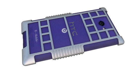

Thanks for the idea's. I came up with a Windows 8 theme case and designed it yesterday. What do you think? I need some feedback!
I plan on having a LOT of different designs available so users can pick there own design. I want the hardware to be just as custom as the users start screen. Thats the base of my idea! We have very unique phones, and each of us are unique, so why should we all have the same case?
P.S. That case is based off of MY home screen. HTC clock in the middle, with all my call, IM, mail and other icons in small around it.

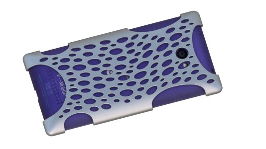

Just another quick update. Here is a render of the new case design. The new design covers more area and is 50% thicker then the old design, plus is a 1 peace snap on, not a 2 peace. Im printing two, but the printer is backed up for the hilidays. It may be after Xmas that I get them!
Anyways, here is a sample of the new design. If people like the web design, it will also be available in the 1 peace, and will be a bit cheaper.
very nice let me know when available
And here is an example of what can be done with custom logo's and names.
Would love some feedback on the new design!
Also, I will be giving away two free cases once I get them. One to an AT&T user, and one to a Verizon user, to make sure they fit both phones. Details on how to win them coming soon!
The lip on the front of the case is less then the 2nd prototype. The 2nd prototype the lip meets the glass. On the new design, its half way between the edge and the glass. This should be plenty to hold the phone since the plastic is 50% thicker and should be stiffer.

Out of all the choices so far, I would buy the Square (windows theme) case.
That's my feed back :)
