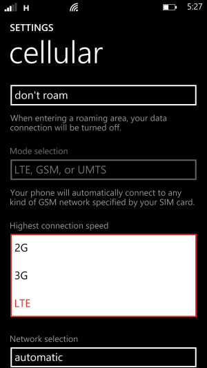

Update! LTE apparently works fine on T-Mobile in my area in southern Michigan! I just changed my max connection to LTE for my commute this morning and, though it shows I have no connection, emails were coming in. So, I fired up the Hardware Tests app and it said I was connected to T-Mobile's LTE. Then I did a speed test in Network Speed Test and got about 26Mbps down, but still no connection on data indicator. Called my wife to test voice and indicator changed to H+ on the call, but has gone back to no signal as I type this.
Moral of the story: don't trust the data indicator, at least not while on a different network!

So, do I have to edit and add BOTH internet and MMS APNs? The internet and data works fine, just an issue with the MMS. I'm assuming it is LTE. I have it selected to connect to LTE and it is quite fast. It displays "H" or "H+" where LTE would normally be.
Install Access point. Then you can go to Settings > Access Point and update data / MMS settings in it and can check if that works.
"H" is HSPA (possibly just HSDPA); "H+" is HSPA+. Both are fast, but LTE is faster.
You aren't going to get LTE on AT&T's network with Verizon's handset. The OP got LTE on T-Mobile's network with the Verizon phone, probably because of a big frequency swap that T-Mo and VZW did in January. (I'm guessing that T-Mo is now using the VZW spectrum in the area where the OP lives.) Sorry.
