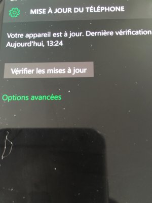

Insider Configuration Update Error

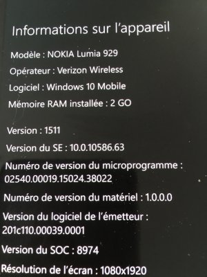

Mmmmmmm my phone is in 10586.63
Weird!!! It's not the last build !!!????
And my phone indicate he have no software update disponible!!??
Has it worked for you? :) if so have you got any screen shots?

so has it worked? if so can you provide screen shots??

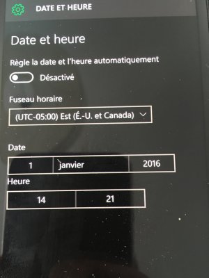

did you change you date to 1 janruary 2016 and turn of automatic date and time then check for uodate?>
Woot! That actually worked! I had originally set it back an hour or so, didn't work. Then I tried one week (january 22, 2016). Still a no go. But... January 22, 2015--BAM, it went through. Must not like 2016. (I don't blame it).
Thanks for the suggestion Deanig_12!!!!!!
