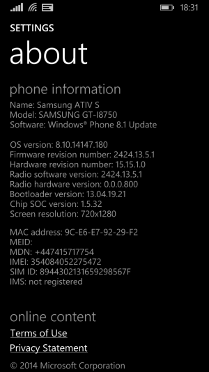

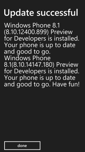

Todays update working fine on Samsung Ativ in U.K (T Mobile).

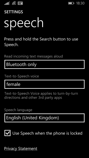

Cortana in English at last! :smile:
