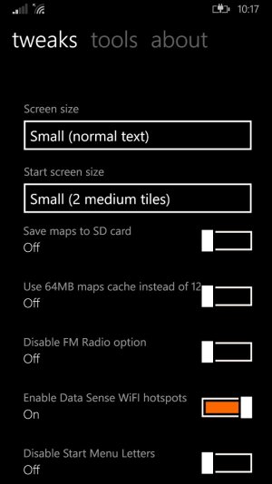

I was able to interop unlock my Lumia 830 (ATT RM-983) following this guide (thanks ca_guri for pointing me to that). There is at least one other user who was able to deploy the latest WPH Tweaks using WPPowerTools on XDA (note that I was only able to use the WPPowerTools after installation of MS Visual Studio, the light version didn't work with it).
Was able to deploy WPH Tweaks and tweaks work (see below).
I was also able to install IO Explorer - cool!
Using it I was able to confirm that the toggle to save maps to SDCard works (MapData)
View attachment 106300 View attachment 106301
