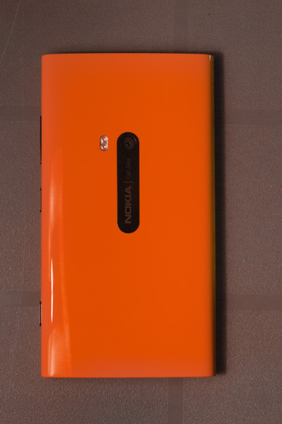

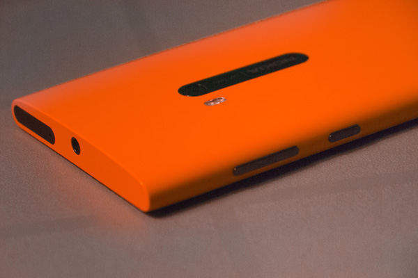

My custom modification of a factory OEM Nokia Lumia 920 shell.
I just loved the Dual Shot design of the Lumia 620, so I improvised and created a dual shot for the Lumia 920 by using the Duplicolor Metalcast paints. These coloured paints are transparent, which creates the same Dual Shot effect of the Lumia 620.
I wanted an orange phone so I started with an OEM Nokia yellow shell and shot a very light application of Metalcast Red with a couple coats of clear. The result is a gorgeous orange dual shot finish.
I polished it off by wetsanding and using 3M polishing compounds.
Duplicolor Metalcast part numbers:
MC200 - Red Anodized
MC201 - Blue Anodized
MC202 - Yellow Anodized
MC203 - Green Anodized
MC204 - Purple Anodized
MC205 - Orange Anodized
MC206 - Smoke Anodized
3M Polishing part numbers:
Start with 05954 Medium Cut Rubbing Compound
Then 39002 Fine Cut Rubbing Compound
Finish it with 05990 Hand Glaze
Here is a short video of the entire procedure.
Nokia Lumia 920 with Dual Shot shell - YouTube
1.
2.
3.
While I do really like it... I kinda really liked the matte yellow look that I achieved in the process of making the Dual Shot Orange. I might switch it to yellow. Or make another dual shot of some crazy colour like purple. Also remember that you can layer two Metalcast paints on top of each other so you can make a Tri Shot or Quad Shot shell (or even more) if you wish!

To me, the dual shot aspect comes from the blending of a solid base tone with a transparent/lucent top shell to achieve a very unique colour and look. The transparent shell creates a "candied apple" kind of an effect, which is beautiful. The Lumia 620's lime green colour wouldn't look nearly as striking if the colour was achieved in one stage rather than two. So to me, the Dual Shot aspect is the look and colour achieved through the two colour stage process, NOT the two colored border around the edges. At least, this is the aspect that Nokia stresses in their Dual Shot marketing. This technique is well known in the automotive world as "candy", which is where I got my inspiration from. People use candy paint techniques in custom paint jobs due to it's very unique look, which is very similar to the look the Lumia 620 achieves. So it's much different than just changing it to the exact tone I like. If that is what I wanted to do, I would have first sprayed grey primer and then hit it with a solid orange paint.
So I guess Dual Shot may have a different meaning to different people, but this is my take on it.
OP, it is possible for you to give some rough times you took on each stage of the sanding and how long the paint took between coats? As far as I know opening up your Lumia like this will void your warranty but if that's not a concern for you this could be a brilliant DIY project. I'm really interested how well this effect lasts, whether you'd have to keep re-polishing the case again as you're polishing it through rubbing compounds. I can't believe how good the result is that I'm really considering doing this myself I just need to know how well the effect lasts and if the paint comes off over time.
