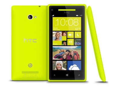

Awesome! Okay, now if you can tell me how to get the HTC 8x Lime Green color on a Nokia Lumia 920 shell I would love you forever, lol. I knew I wanted the Lumia because it is a far better phone but I love the color of the 8x in Lime Green.

you can probably achieve the lime green color by starting with the cyan shell and hitting it with metalcast yellow. That would probably get you in the ballpark.
