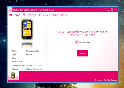

I just installed Nokia Software Updater for Retail (version 3.0.8) and it shows that there is an update available for my Lumia 620.
I notice that it is a very minor update, however I'm not sure. Should I go ahead and install the update? Are Windows Phone 8 updates cumulative? GDR2 will be available next month anyway, so should I wait for GDR2?
I have one more question: Is it safe to update firmware using Nokia Software Updater for Retail? And if I don't backup my phone and after the new firmware is installed I then sign in with my Microsoft Account, will I at least get all my contacts and purchased apps? I'm only worried about contacts and purchased apps. I'm not all worried about settings etc.
Updates are cumulative so if you decide to wait for GDR2/Amber you will get all other updates that have been released so far. Updating using that software should be okay but it will wipe user data from the phone. Restoring your contacts and paid apps shouldn't be a problem once you've signed in with your MS account. Your contacts should automatically be restored to the phone and any paid applications can be re-downloaded without having to pay for them again. Just tap "Buy" and you will be taken straight to the install screen, by passing the purchase confirmation screen.
Have you tried updating over the air by looking in Settings > Phone updates > Check for updates? This method of updating will not erase any user data.
