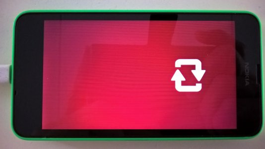

L630 reboot loop with strange screen
Hello,
After a failed attempt to update my lumia 630 to the latest insider preview of windows phone i'm stuck with a device that's in a reboot loop. The phone boots with the word Nokia and then displays the attached screen. After about 3 minutes the phone reboots and it all starts over. I tried to roll back to 8.1 with the windows phone recovery tool but that does't work.
Has anyone seen this screen before and knows what it means and how i can restore my phone?

This screen is shown when Lumia recovery tool is installing updated windows phone on mobile. You should not unplug your phone during this process.

The screen is showing even when the windows phone recovery tool isn't updating. During the attempts to recover my phone with the recovery tool it gives me a error after approx. 5 minutes and stops, the phone then reboots.

  • Run through the process starting at the first bullet point again and once the recovery image is actually done installing, that red screen you show in the original image will flash green and your device should reboot. There is a chance this will be WP 8, but you can do any updates you want from here.
