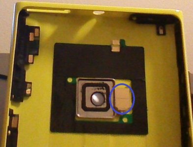

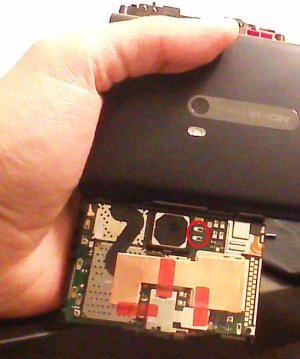

I figured out how to fix this problem. You need a T5 screw driver to pop your phone open. You can follow this http://www.youtube.com/watch?v=MpS2XncKxSU
And then use a small flat screw driver to lift 'up' the two metal connections right next to the camera as circled in red.
When you put the phone back in the housing, you want those two metal pins to be touching the surface circled in blue.

+1 to peter14f's solution. Worked perfectly - getting the back off was tricky, but using a spudger helped a lot with that. I suspect that if it fails again ( the pins bend back down ) that I'll take it apart again, and add some solder to them for a better solution.

Thank you so much for the fix. I was quoted $100 by a local phone repair shop but after watching a couple of you tube videos on disassembly and using the pics in this thread it took about 15 minutes to get things working. To check for a hardware failure it is necessary to press near the light before turning on an app. Using the SOS on my flashlight app creates on/off and allows to press on the phone while the app is running.
