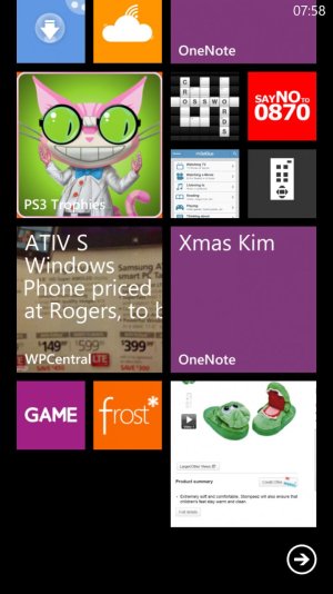

I can't believe headlines still get cut off on live tiles, that makes a lot of them just useless as you still need to open the app to check what the stories are actually about.
Yeah it is a bit odd. To be fair though, thats one of the few times I've seen it happen on the WP Central App. Usually the headlines are short enough to fit. It's still a bit naff though and I think they should scroll or something.
It's happened before on WPCentral, I disabled all my news apps because of that, that's just ridiculous. There's no glance and go if you have to open the app to read the full headline, why can't these apps use small fonts like on the Me tile? I know in WP7 developers didn't have access to smaller fonts and it looks like this hasn't changed in WP8.
I can undoubtedly say that this doesn't occur with BBC Mobile and News360. Full headlines are shown and don't get cut off. This leads me to believe it's on the dev to make sure this doesn't happen. Weave may be another news app this doesn't occur on.
An easy way around that would just be to render an image with the text on it in the font of your choice. I don't see why you'd HAVE to use the text property on he tile
I discussed that with a few devs and although they're aware of the picture rendering solution, they all agree it's a lot of work for a small task. They were hopping font resizing would be in WP8 which I don't think has made it. The Me tile does use different sizes depending on the content so it's really Microsoft not playing nice with developers.
