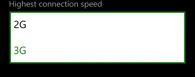

Hello, I have Lumia 1020 Vietnam firmware (RM-875_apac_vietnam_234), 4G sim and in 4G area. In cellular+SIM no 4G option, only 3G and 2G. Dialing ##3282#, network type 4G only not working, catching 3G signal. Any help?

There's some problem: When I go to ##3282# and set 4G only option, and go back, again dial this, network type is set to automatic. Toggle ENS on. How to enable 4G?
Yes, I have changed standard sim to 4G sim 15 mins before, but when the phone starts, it has EDGE signal. I must manually change to 3G in cellular+SIM, but no 4G option..
1800Mhz, Band 3 use my provider, but in LTE band on ##3282# I have Band 2,4,5,17...

triturbo, I have tried from another phone with the same SIM, and caught 4G.. I am in 4G coverage with 4G sim definitely.. Problem is in my phone - windows, he doesn't have a 4G as a fastest connection speed in cellular+SIM, only 2G and 3G.. Anything other to do? Will be windows 10 for mobile able to handle 4G? Is it worth to wait?

Mình cũng đang dùng bản RM-875 mua chính hãng FPT. Thông số RM-875 rõ ràng hỗ trợ LTE band 1, 3, 7, 8, 20
(2100​/1800​/2600​/900​/800 MHz). Trong khi vào kiểm tra ##3282 # thì ra LTE band 2, 4, 5, 17
(700​/850​/1700​/1900 MHz). Sau khi tìm hiểu nhiều thì mình khẳng định đây là bản mã RM-877 vốn sản xuất cho AT&T nhưng còn tồn. Bây giờ Microsoft unlock xong chuyển về Việt Nam bán. Nên nó chỉ hỗ trợ băng tần Bắc Mỹ thôi. :(
I am also using the RM-875 buy in FPT shop. The RM-875 clearly supports LTE band 1, 3, 7, 8, 20
(2100/1800/2600/900/800 MHz). But when I checked ##3282 #, the phone supports LTE band 2, 4, 5, 17
(700/850/1700/1900 MHz). After learning a lot, I confirmed this is the original RM-877 code for AT&T but survived. Now Microsoft unlocked and then shipped back to Vietnam. So it only supports North America LTE band. :(
