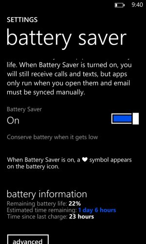

http://forums.windowscentral.com/no...-intouch-nokia-background-process-issues.html . My friend read the link to the post i uploaded yesterday. I was having the same Issue and got to notice an app on the background process was the cause if i switch my phone off and back on my battery stat report 1day and 19hrs on 43% battery i had at that moment then after some time all of a sudden going back to the battery stat in the setting shows me i have 7hrs for 43%. i tried having battery saver to on always (under advanced setting) and switched off & on the phone it was at 1day 20hrs for about an hr but switching the saver off again after few minutes battery stat went to 8hrs on 42%..... so i concluded it was an app.
1st i unistalled my foursquare switched off and on back after some time battery dropped significantly from 1 day plus to 6hrs
2nd i uninstalled metrotube & whatzup app and switched off & on... at the moment of switching on my battery stat was at 24% and i woke this morning to see my battery stat is at 22% with a day and 4hrs of use still left.
So my verdict is that whatzup app or metrotube is the culprit of this drain but am putting my money on whatzup app cause its the only app that has reason to unnecessarily be in the background process always but i think the implementation is not very good.. And these four apps i switched off where app that could still run in background even if they were blocked.
n.b i dont have any battery app installed and i use a Lumia 1020 as well..... so try going through this processes i did and see if your battery problem will solved.
Also i have try all apps i have installed now and battery seem to be holding up fine. Have never had the battery this good before. At moment i have only two apps running in background weather and facebook beta. And will try reinstalling foursquare and metrotube and see if thing stay same . will reinstall whatz up app last to know if problem comes back for certain
