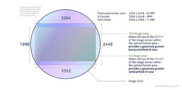

The final image size is actually determined by the image ratio you choose. Shooting in 16:9 yields a 16MP image and 4:3 yields a 19MP (called 20 MP in advertising). The difference comes from the fact that the 16:9 image is just a crop of the 4:3 image. So if you want to use all those pixels, shoot in 4:3 then crop after if the image would look better in 16:9.
That is completely incorrect, please don't spread misleading information.
How and why is this incorrect? Aspect ratio is determined by the hardware, the L1520 doesn't have two different sensors, or changeable anamorphic lenses, so one aspect ratio must be a crop (or digital distortion) of the other. Using the cross hairs and a tripod seems to confirm that the 16:9 is just a crop of the 4:3, as does the fewer number of MP used.
theefman. If you follow the link from Harrie-S there's another link that compares 16:9 to 4:3. And while 16:9 does use a slightly wider portion of the sensor I'll be sticking with 4:3 because I see very little additional width on the image using 16:9. So little in fact that I had never noticed the difference.
Nokia Lumia 1520 camera looks set for dual shot 16MP + 5MP mode
"The 16MP high resolution image size suggest the Lumia 1520 will have a camera with a native 20MP resolution. However, because Nokia provides true 16:9 and 4:3 aspect ratio modes in its cameras, the corner portion of the sensor is not used, hence the lower real megapixel output (16 MP in the case of 16:9 mode, and likely around 18 MP in 4:3 mode)."
Image size is actually determined by the image ratio you choose. Shooting in 16:9 yields a 16MP image and 4:3 yields a 19MP (20 MP). The difference comes from the fact that the 16:9 image is just a crop of the 4:3 image. So if you want to use all those pixels, shoot in 4:3 then crop after if the image would look better in 16:9.
No it's not.
If you use 4:3 you use 19 out of the 20 mp of the sensor.
If you use 16:9 you use 16 out of the 20 mp pixels.
If you afterword's cropping a 4:3does not make the picture "better".
