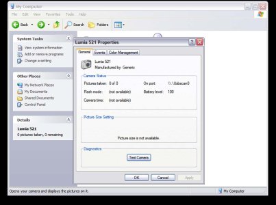

I just recently got a Lumia 521 (contract free T-Mobile) and I am having issues having it be recognized by my laptop. I am using Widnows XP SP3. I understand that there is no Windows Phone synching suite application for Windows XP but only for Windows 7 and 8. All I am trying to do is use Windows/File Explorer to transfer over files to the folders on the phone. My issue that I have is that my laptop only recognizes the Lumia 521 as a camera (see below) and not as a mass storage device. I do skip 2 pop ups stating that I need device driver for the phone, I cancel those, and I get two errors stating that the device may not be read correctly or supported. The one that seems to work correctly is the plug and play drivers that make it be read as a camera. I do see the phone/files but when I try to transfer over files I am not allowed to do so, only sync photos from the phone to the laptop.
Does anyone else know how to correctly have the phone be detected by Windows XP as a mass storage device? Or anyone know the correct drivers that i can download? This would be really helpful as I would like to add/change my own ringtones, notification tones and photos on the phone. I'm migrating from Android which I had no problems connecting with Windows XP but this is a big issue for me. I am already second guessing having gotten a windows phone and might just end up using the Lumia 521 as a glorified MP3 player since I can add stuff to the SD card. The reason I am trying the Lumia 521 is cause I like Nokia, my previous phone before Android was a Nokia N95-3.

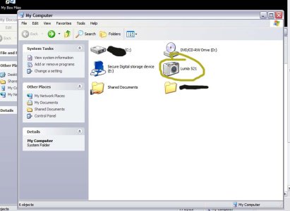

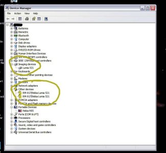

Still no luck on this. It just reads as a camera. I had also thought maybe becuase I had not activated my SIM card on the phone yet that would be a reason it was being read like that but that wasn't the cause of the problem. I do cancel all of the notifications of installing drivers but somehow it automatically recognizes the phone as a camera (see photos). I even go into the drivers settings to delete the the one it reads and try it again, which doesn't work.
Has no one else encountered this problem? I would also note that I did not connect the phone to my laptop until after the new update, which I'm assuming is the new Amber update everyone is talking about.

Windows XP - when installing the 521 cancel all prompt when it ask for updating software. If still have the problem then disconnect the phone from PC. use device manager and remove the 521 that is listed and then reconnect the 521. If still not working try a different usb port or usb cable. Works fine on two WinXP Pc with SP3 (friends and moms)
try uninstalling the imaging device first, and reconnect the phone
just try and it works for me

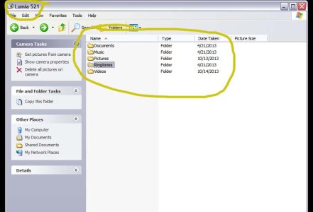

I wrestled with this for a while too, after re-installing Windows XP. I had to install .net framework 4.0, and then go into the control panel and scanner and cameras, then delete the Lumia from the list of cameras. I re-connected the phone, and it installed as an MTP device and I can now browse my phone from windows explorer and it does not show the scanner and camera wizard anymore when I connect the phone. Hope this helps. I had also installed some winusb drivers from Microsoft catalog, but I don't know if that made a difference.
Simply go to the XP device manager and disable any/all listings that say Nokia 521. TaDa........

I've looked on NOKIA's website and it said that LUMIA 1020 doesn't work with XP/VISTA, but solution was so simple.. have screen on, put password in...
