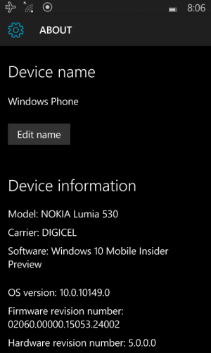

I can confirm I got 10149 installed on my 530. Did a hard reset after the upgrade and all seems well thus far.

after a long time I seen the Screen short of L530 W10TP.. Above Tnks ttsoldier .

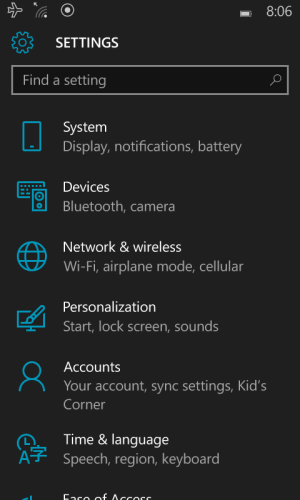

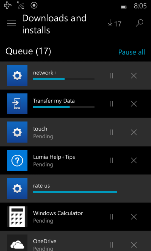

works good on 530. better than I expected.
