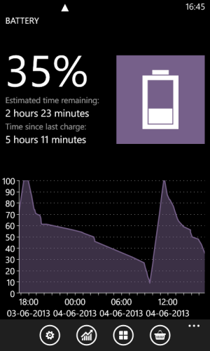

Hi All, I have read a lot about Nokia Lumia 620's back up and with varying opinions about the life of battery.. from 5 hrs to even 24 hours and more... i have been using it for past 3 days... have to ask... is a 8-16 hour backup normal????
i mean coming from E5 this really sucks... but i guess thats what smart phones are offfering these days....

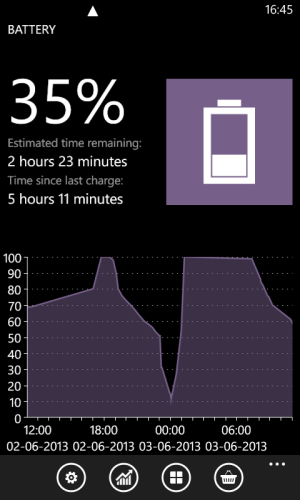

i have FB connected and also have 2 accounts syncing use about 30-40 mins of net surfing and also 20 min of whatsapp.. and some random apps.... i have not made any calls or music... played about 10 mins of game that to today

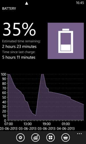

following are the screen shots of rise and fall of battery and i must say it drops really fast and then stabilizes
is this normal??? or should i see the nokia center???
I don't believe this is normal. Your battery looks like it is draining far too fast if it's sitting in locked mode for a lot of the time.
You say you use Facebook and WhatsApp. I believe these apps, particularly WhatsApp can suck a lot of power (possibly a bug in the apps). You could try stopping these from running in the background for a while and see if the battery life significantly improves. With WhatsApp in particular, you may want to uninstall the app to see if battery improves. I believe there is an update for WhatsApp on the way that addresses the widely reported battery drain issue with this app.

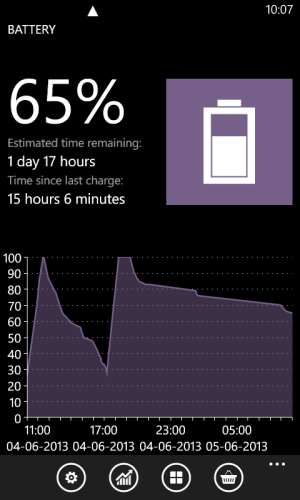

Firstly thank you so much for the reply... yeah today i have just disabled the internet..and the phone has been idle (used flash light once and bluetooth to transfer the pic) to see whats the deal with the battery...

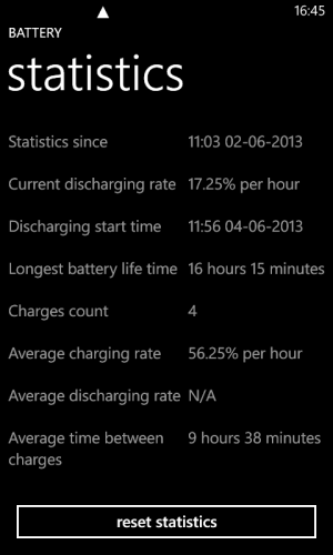

as of now the stats seem to be...
the deal is after the full charge the battery falls pretty sharply.....(is the same happening with everyone else...???
a point to be made is that many people mentioned that the battery improves a lot after first few recharges.. and my total count as of today is 5
is there a need to go to Nokia Care center right away or should i use it for a week more to see whats the deal with it....!!!
No. I don't see this behaviour. But you might need to charge again to see if it repeats the same pattern. Might have been a one off.
This is a myth. Lithium Ion batteries don't 'improve' at all after a few charges. What can happen is that the 'estimated time remaining' can get more accurate because the software monitor gets more data to work with.
Up to you, but I think you've got a software problem, not a phone or battery fault. Temporarily uninstall Facebook and WhatsApp for a couple of days and see if your battery life is normal. If so, it's an app issue, so changing phones won't help.
