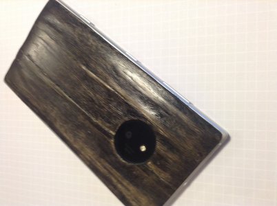

Luckily my 830 came with a black back cover and a green one (which really isn't my taste) so I took the green one and made this:

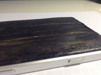

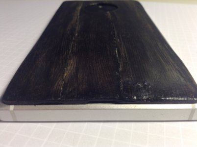

I am by no means a woodworker but it actually worked pretty well. It looks thick in the pictures but it's really less than .5mm thicker than the OEM back cover.

UPDATE (1/7/2016) Been using this for 3 months now, and it is working great! Absolutely no problems, a little bit of wear to the veneer on the corners but I think it looks better actually because it fits with the reclaimed wood look I was going for. Stay Awesome!
