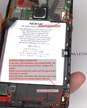

I have this inssue after I let the phone fall hard yesterday.
I FIXED IT by open the device thanks to youtube LE55ONS video (sorry. You need to google "disassembly lumia 920" because i can`t post links here...) and try the points of a BROKEN LCDs how to (google "How to Solve Nokia Lumia 920 Network Problems").
Thank you guys!!!
In my case, the cable connector antenna came loose after I let the phone fall to the ground from a height of about 2 meters.
Simply reconnected the cable and the signal level returned to normal.
Check all other connectors also because some may come off due to a hard impact suffered.
Below is an image taked from the LE55ONS video to clarify the solution.
My Lumia 920 is live again!!
I hope this is helpfull.
