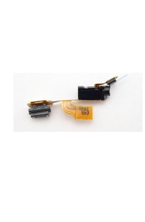

I can confirm that in my case it wasn't a software problem (yes it stopped working after wp8.1 upgrade) but actually it was hardware issue all the time. Since I didn't have warranty on this one, I've purchased flex cable on ebay which contains microUSB, 3.5mm headphone slot and a second microphone, it was 6usd (here is the link to the one I bought www . tinyurl . com / qfkxgev ) It seems that I cannot post links because I don't have enough posts, but you can figure this one by yourself :)

My Lumia 925 no longer has warranty. So I bought this part 4573978121.jpg containing jack, usb and second mic. It costs about 8 €. Then replaced it myself. You can find videos in internet how to dissasembly the phone and where to find this part. It is not that hard. You will also need two torx screwdrivers size T3 and T2.
Now Cortana works flawlessly also with music recognition and records voice with videos.

I got a like new Lumia 925 off eBay, perfect condition. I enjoy it for a week or so until I realize it has the dreaded speakerphone problem. I like it even more than the 920. Anyhow, seller apologizes and offers to take the phone back or return $30. I find the solution of replacing the USB /Headphone Jack / Microphone port. Ingenious. No other Nokia I've had has this modular system to replace the ever-failure-prone USB port (N900 and N9 in particular!)
So I order a new 925 ribbon cable setup off eBay and a few pieces come in a plain white envelope, the rest is totally smashed in the USPS.
I order a new one from a seller in China - it comes safely wrapped but misshapen. I squeeze it in but now the speakerphone works but the internal mic does not!
I order a new one from a different USA seller and the speakerphone works but not the internal mic. #frustration
A fourth one comes in the mail from China (123Phone) and finally I got the phone to work with both the internal and external mic. Caller say the internal mic sounds a bit staticky but the new top mic and calls through Bluetooth Headset sound perfect.
