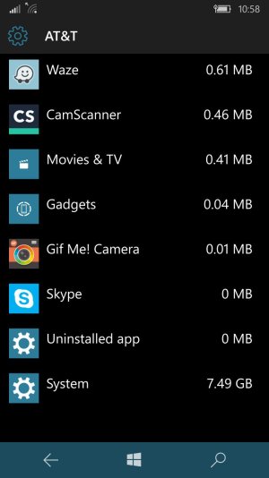

Anyone else having high data use in the system apps? This is my second 950. The first device was replaced under warranty because neither Microsoft nor At&t tech support could explain the high data use. I have the 10.0.10586.36 OS build. The system app used 7gb of data in nine days over the cellular connection with all the apps turned off for background data. Now the new device is doing the same.wp_ss_20151230_0004[1].jpg
Check if you have One drive set to auto backup. Under system you also count SO an FW updates. Also check if you submit feedback automatically. It is a very known bug this. However looks it is fixed in current .71 insider build (available on slow ring just like the .36).
Try an update on .71 since you already are an Insider....

All my feedback and crash logs are turned off. Software update and FW are set to wifi only. I even found a setting under SIM called "Enhanced 4G LTE Services" that uses more data for HD Voice but still made no difference. I did notice about forty files in my picture folder on my one drive with .rich extension that I couldn't open. They were 22mb each.
Yup, that is also a potential data eater.
Those 22mb image files are the RAW pictures taken. It seems that the album app has auto backup option on on your phone. Disable that also (inside the app settings).

Anyone else having high data use in the system apps? This is my second 950. The first device was replaced under warranty because neither Microsoft nor At&t tech support could explain the high data use. I have the 10.0.10586.36 OS build. The system app used 7gb of data in nine days over the cellular connection with all the apps turned off for background data. Now the new device is doing the same.View attachment 121925
I have the dual sim 950, and have noticed now that the SIM2 under data usage has over 150 MB (84 MB system data) of usage while SIM 2 is not even populated. My AT&T SIM (SIM 1) has used about 400 MB with 118 MB of it being system data. Are you seeing this on a Dual SIM anyone, why is this?
I disabled most of my apps from running background processes, not sure if this helped but I have not experienced anything that high, 7 GB is outrageous!
