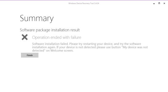

GUYS I NEED HELP!.. NOW MY PHONE IS A BRICK! i cant do anything with it. it keeps reboot with :-( face, tried with the windows device recovery tool 3.4.34 and it says software installation failed. What should I do now ?
OK NOW ITS WORK! you know what is the issue ? THE USB 3.0! I unplugged the device, switch to usb 2.0 it work smoothly. Darn!
