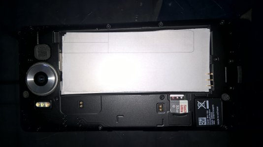

I bought a Lumia 950 around January 2017, and everything worked perfectly (hardware wise) until May. My device began to randomly reboot/restart, and I could not place my finger on a cause or an app that could be responsible for the crash. I performed several hard resets but nothing was solved. So I began searching online in different forum threads. I came upon a mention about something related to faulty batteries, and one user proposed a solution that worked flawlessly for me. This involves placing paper sheets the size of the battery underneath it, and another one wrapped over the top side (opposite to contacts) before finally closing the back cover.

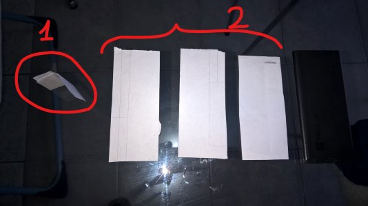

Getting into details, you will need 3 sheets of paper (any paper suitable for printing will do) cut to a size slightly smaller than that of the battery (marker 2). Also, you will have to fold another small piece of paper in two, which will wrap over the top side (marker 1).
Then, place the first three pieces where the battery will be located, making sure the contacts are not obstructed.

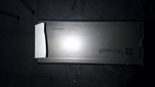

Now, grab the folded paper and place it over the top of the battery.

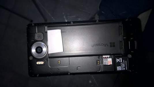

Finally, put the battery with the paper on its top side, into the phone, over the previously placed paper sheets, and close the back cover.
After doing this, my restart problems vanished, leading me to believe there is some dimensional issues between battery and the phone that might be allowing unwanted movement and the "battery pull" effect causing the reboots.
