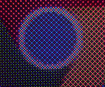

I tested smearing. That does exist only on the EDGE of the gray while scrolling. And that's because it uses the diamond pentile arrangement of pixels. In fact if it wasn't for the ultra high pixel density you would be seeing the purples and colours around text and other stuff. You may be able to see it if you use a magnifying glass just on the edges of text without even having to have to scroll. It's designed so amoled lasts longer but isn't noticeable for the most part. But the scrolling of that picture may make it noticeable because of the brightness and interval it refreshes at.
This is an image from the Galaxy S6 edge which uses a similar display. Upclose chrome logo. You'll notice the colouring around the gray, though it's not noticeable with the eye due to high amount of pixels.
As far as the Gray's looking green, I don't have that issue. I tested it on the "standard" colour profile and my advanced one. So that one I can't really replicate. I'm on the latest firmware and latest redstone build.
