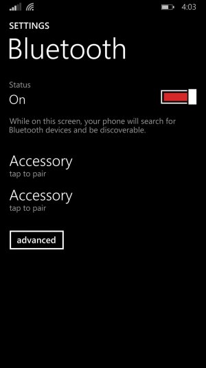

I have the latest Denim update and when attempting to connect to anything via Bluetooth all I see is Accessory but can't connect to any of my devices. Has anyone seen or have this problem?
I presume your BT devices are paired. If so, try doing a soft reset. I've run into this before where my phone has problems connecting to BT and even WiFi. A soft reset cleared things up.
brownman2130
Feb 15, 2015
2
Visit site
No, they are not paired. This is a new device and I did a hard reset to install Denim. Below is what I see in my Bluetooth list and it won't connect to either 'Accessory', both of which are mine but cannot view the name of the bluetooth device or cannot connect.
Are you putting the devices in pairing mode? I had to do that when I re-paired my Chevy Equinox and my Microsoft Band after a hard reset. I haven't re-paired it with my SP3 yet. I'll give it a try and see if the same thing happens.
