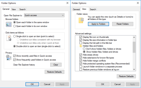

Most likely they are hidden, plug your msd card into a reader and set your folder options to show hidden files.
Top left hand corner in the file explorer - > view tab -> show hidden files + folders, you may have to untick hide system protected files as well.

I've tried show hidden files before but, they didn't show up , I'll try again & see :)
Did you untick - hide system protected files?
Also did you put the msd card into a reader or are you using the phone as a card reader (plugged in via usb)?

yup I did use a USB card reader in usb 3 port ... i'm not sure about un-ticking hide system protected files .. after finishing the current OS update, I will get the SD from the mobile & try again :) .... I have an important meeting in 45 min from now .. i'm afraid i'm gonna have to leave & comeback later to try out :) Thank You bro .. I'll keep you updated with steps & results of what I do :)

hello, I have checked back & i found that I didn't un-tick it .. so I did & I managed to cut all the original files from the SD card, I will try to download all the apps again & replace their new files with my old ones & see if it will work or not :) {I hope it will :D }
