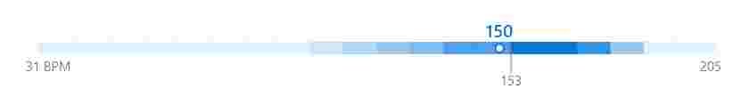

Hi,
There seems to be something weird with my maximum heart rate in microsoft health.
Under the comparisons, it lists my maximum heart rate as 150. The band regularly registers and records a heart rate over 180. So does anybody know what is going on here?
This is microsoft's explanation, which doesn't seem to square with my own experience:

Here are some screen shots:

I know one common formula for max heart rate in BPM is to subtract your present age from 220. Don't know how old you are but you do obviously.
Also, from an unrelated website, "According to the American Heart Association, your target zone ranges between 50 and 85 percent of your maximum heart rate. For a person who's 40 years of age, this target zone is between 90 and 153 beats per minute. Keeping your heart rate within this range ensures your workout intensity is high enough but not too high to put strain on your heart". It might be that MS is being conservative in what it considers max heart rate.
One other thing, I don't know exactly what they mean by "peak heart rate". I'm not sure if they mean that's your recommended maximum, or that's the highest it has measured. One page shows where you can export your stats in CSV format and it lists this as one of the fields:
HR_Peak -The peak heart rate recorded during this activity.
In that case it sounds like it is the peak measured during exercise. That doesn't make much sense as you are seeing rates as high as 180 though. Maybe it throws out spikes when it does its calculations or something.
I never really paid much attention to that comparison chart. Mine shows that my peak heart rate is 156 compared to the average for my age & gender at 157. However, most of my running records a peak of anywhere from 170's to 190's depending on the workout. With the original Band, I ran a half marathon last April, and my peak heart recorded was 193 with an average of 177. This past Saturday with my Band 2, I ran 9 miles with a peak of 189 and an average of 158.
I don't really know what the Peak in the comparison chart means. I don't feel like it has been affecting my calorie burn calculations based on my daily activity or my recorded workouts, but I really don't have any other gear to compare the measurements with.
The only other HR monitor I've ever used is a chest strap from Adidas miCoach. That thing was very inaccurate for resting heart rate, always measuring in the mid 70's when it was usually high 50's or low 60's, but the heart rate during exercise was actually much closer to the Band.
Well, I am definitely no marathon runner. And if a marathon runner's max heart rate is reportedly 156 then I still feel pretty good with 150. Yet as of today the MS Health Dashboard now reports 149. Oh bummer and I did not even have my birthday... So that show me that they certainly don't do the 220 minus age thing, which would give me 175 by the way...
Anyways, I should probably not take this max heart rate too seriously whatever it means. But it remains puzzling why MS reports it. But perhaps jsooney is right and it is my recommended max heart rate for cardio exercises. Would just be good if MS explained this to me.
Best , Danckel
