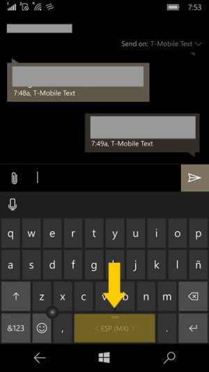

Have had the strangest issue, all of a sudden, my L950XL has changed the autocorrect in my messaging app to Spanish. Just happened yesterday, don't know why and don't know how (see screenshot).
Anyone have any idea how this happened, or better yet, how to change it back to English?

Ok don't kill me, but did you try to move/swipe to left/right on the spacebar?
Also did you check settings?
Well, I tried that after reading your response, and what do you know, it's back to English. Don't know when I swiped it to change it, but must have not knowing. Thanks much for the insight, and the solution.

You should consider removing the keyboards you're not using, as a precaution. I have two installed (Dutch and English). The phone had Spanish pre-installed, but I removed it lol

Ok, sounds like a good solution, however I have gone into the language section in settings and see no way to remove the Spanish selections. Any insight as to how to do this?
Scratch that, found the keyboards, and was able to delete it. Thanks again
If you only want to remove the keyboard:
settings > time & language > keyboard > long tap on the one you'd like to remove and .....
