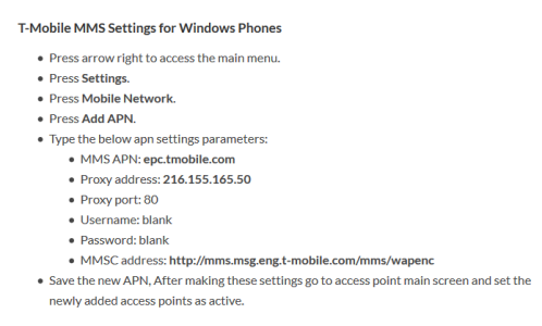

Will this work? ... Reason I'm asking is I'm expecting a 950 this Friday. It's for Nokia -- maybe settings will work for 950. Menu navigation will be different on the 950 I'm sure.

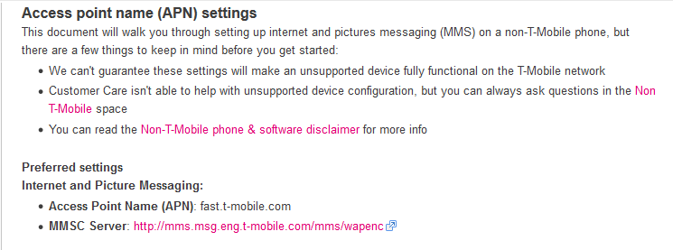

...from the T-Mobile site:
Thank you. Sadly, that also didn't work for me. It can't be my sim because I got an MMS on my iPhone and my last Android without any issues. Yay for you getting a 950, I hope you'll have better luck.

Edit: the "preferred settings" listed above are what I have and everything works perfect. The only other change I made was IPv4v6 but I'm not sure that even matters. Are you then saving the settings and then immediately sending yourself a picture? I remember reading somewhere by doing so makes the settings stick.
I'll try to attach a screenshot of my settings shortly. I have a single sim 950 on T-Mobile.
Yeah that is what I am doing. Are you saying that you changed it to IPv4v6 or that you left it there? I am going to try that and hopefully that will work. There's a setting that has PAP selected. Did you change that or no?
