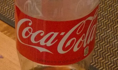

I have a Lumia 1020 and while I always thought the camera was good, I didn't quite understand why everyone praised it as much as they did, since my photos often came-out slightly blurry and the lossless zoom wasn't quite what I expected it to be. However, I just chalked it up to figuring that I had unrealistic expectations, so I never really looked much into it.

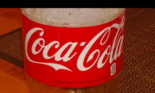

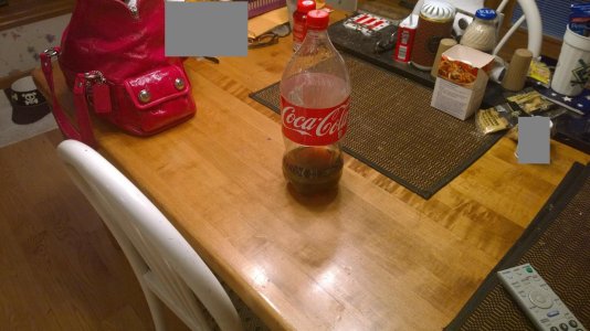

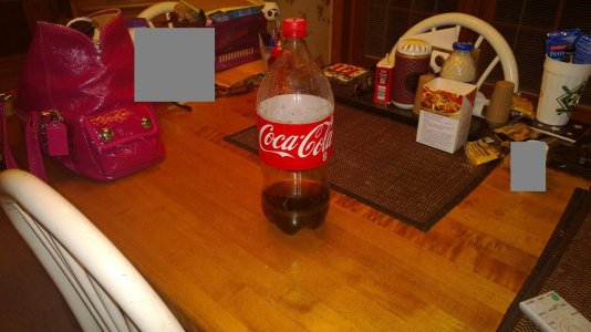

This weekend, I compared my 1020 to my dad's 1020, and my dad's 1020 absolutely out-performed mine. To keep everything fair, I kept both phones on full auto settings and I took pictures from the exact same angle and distance. His pictures from a distance looked about the same as mine, but when you zoom in, his pictures stayed crisp and mine had a lot of static in comparison.

Mine: PT Coke Bottle1.jpg
Dad's: Dads Coke Bottle1.jpg
Mine: PT Coke Bottle2.jpg
Dad's: Dad Coke Bottle 2.jpg

Edit: I should also point out that your dads picture seem to be a lot blurrier and with a different white balance, so it may just be different auto settings. You could also try setting the manual mode to the same instead of having it on auto to see if it makes a difference.

to me it looks like different auto settings , have you checked the picture exif data too see what the camera was doing? your camera looks like it used a higher iso and slower shutter speed , your dads look like it used a lower iso and fast shutter speed
I can make my 1020 do exactly the same thing by changing the settings , I often do to get a better xenon shot with more detail as the auto settings can be a bit hit and miss with the 1020 , the auto xenon settings tend to use shutter speeds of like 1/30 second and a iso of like 400 or higher to give a more natraul looking shot at the expense of clarity and detail , I personally like to use iso 100 and a faster shutter speed to make the shot as clean as I can ...... this results in pictures that look much more 808 like with less orange/yellow being absorbed from surrounding light sources
so basically check/upload the exif data from both pics here and we can see what has happened , either that or use both phones in manual and change the settings to the same on both ;-)
idk if its just me, but your dad's phone seems to have flash on...or at least focus light effects on when compared to yours

if you open the pic on the phone , open in nokia camera , then pess the 3 dots , then press show picture details , it should show you the iso , the shutter speed , file size etc
if these aren't the same on each device then the even though both phones were in auto , there might have been a slight difference in light that made each 1020 choose different settings ;-)
it could also be a faulty phone but if these settings are different then it could also be that ;-)
