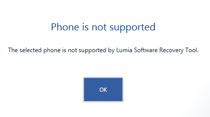

Re: My lumia 620 stoped working during installing the software with windows recovery tool
Always written "the selected phone is not supported by Lumia Software Recovery Tool" or "the selected phone is not supported by Nokia Software Updater for Retail"
My dear Lumia 620, I think you are finally dead :(
