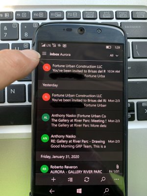

3. I added an outlook account. It is pinned on my desktop. I can access email, it works great.
Problem is, I added a second (exchange) account and I don't know how to actually get to my inbox. Its listed under settings>email & app accounts, but that's it. You can only manage the accounts there, not check your inbox etc. I figure this is an easy solution, but its aggravating me nonetheless.

3. See the attached pictures for this one. In Outlook, use the account picker (where my finger is) and from there you press and hold whichever account you want and select “pin to start” or words to that effect. They will pin to the bottom of your start screen and you move it from there.Adjustments.JPGAdjustments.JPG

3 - Along with what @fatclue_98 said, instead of having one Outlook tile, you can actually pin separate tiles for each account. To do that, go to the menu in the second picture, long press 'Inbox' and there should be a 'Pin to Start' option.

3. Thank you for your help. I am able to find and pin additional accounts via the account picker "3 horizontal bars" icon.
