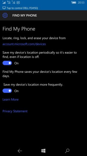

Hello,
Erase protection is one of the major security features all phones (and Windows Phone, AFAIK), have. At least, I thought so a couple of hours ago :) So, I wanted to enable it. I've read the guide here ( windows.microsoft.com/en-us/windows/protect-my-phone ) on MS site, and it's stated here that now it's only enough to log in with Microsoft account on the device and it'll be turned on. OK, did that. Sadly, there is no mention of erase protection anywhere in settings, and also in MS account / devices. So, in order to test it, I tried to make a reset, and it went "well" without asking me to log in into my MS account (it's also stated on MS site that you should be asked for your MS account password after you agree to reset the phone, so, sadly, I didn't have a chance to interrupt the actual reset) :(.
So, the question is, does anyone know a way to turn this feature on and if yes, why MS did it so hard to find?

Sfairat
Dec 9, 2015
14
That's strange :/ Here is everything I have under Find my phone.
Have you been asked to enter your account info before the phone allowed you to reset?

Yeah, but the problem is that I can find no way to enable it (you can see the screenshot of find my phone screen). I think now that it's a region-restricted option and in my region it's not available. But you know, making this option region-restricted is a really, really bad idea :/

But unfortunately it is the same for my Lumia 950XL - bought from TMO Germany, MOID TMO-DE. It is not offering the option under Settings -> Security -> Find my phone, just the two options above. Also when checking my IMEI for the status of reset protection on the microsoft site, it is telling me that it is off. It was like that out of the box.
This is a little unsatisfying :-/ Is there anything that can be done regarding that?

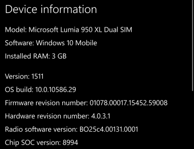

Gosh, that's very interesting. Which version of the OS and which firmware revision do you have?
Mine:
OS Build 10.0.10586.29
Firmware revision 01078.00017.15454.29005
And, yes, I was asked for my username/password when I performed the factory reset.
P.S. I have the dual SIM, US model.

Here is the info. Looks like firmware revision is slightly different. Windows device recovery tools says it's the latest rev available on server for my device.
My device was bought in Ukraine, so I assume this may be related to the european versions of the devices.
