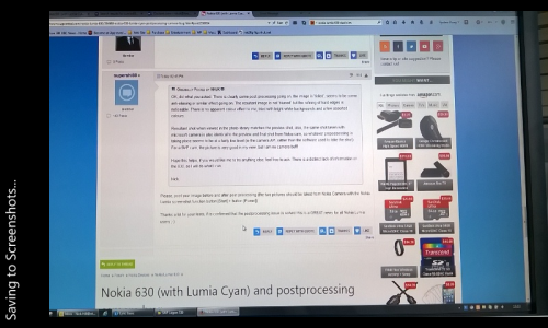

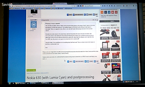

Here you go, the first screenshot is immediately after taking the shot, the second if after the preview is shown.
Sorry if the quality is poor, steady hands, indoor lighting etc. I can try again after work when I have a bit more time :)

From the fist image of NHUK (thanks a lot) we can see that the postprocessing in Lumia Cyan is working differently respect Amber/Black fw: in this case the sharpness is up (and not down like in Amber/Black fw), the wb change only a few and without the
yellowish/greenish mask (in Amber/Black fw the wb is changed a lot with a yellowish/greensh (very) wrong effect). Only the contrast is substantially modified by the postprocessing.
I'm waiting for new photos to understand well if all of these impressions are confirmed ;-)
