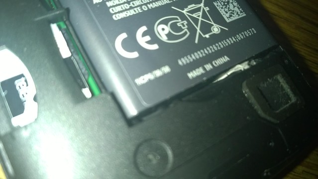

This works! Try the paper technique before you try any software fix. It seems a good deal of the Nokia 520s have this issue to some degree. After two returns of this phone for this problem, the third one I got was the best. It still turned off occasionally, but not as frequently and not as hard to get back on. Sometimes I had to shake the phone to get the batteries to engage with the connectors again. But ever since I wedged the paper in the battery compartment the phone stays on!

Thank you. I have been having this problem for several weeks and even tried to get a new battery to see if that was the problem. Stuck a piece of paper in and it turned on without any trouble.:excited:
