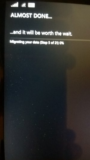

I have what I think are multiple green dead pixels on my screen, I have the odd red on too. I sent my phone off to get repaired under MS warranty to the Anovo Repair Centre but they returned it saying that they could find no issue with my screen. As soon as I turned my phone back on I could see them again. They are mostly visible when the screen is projecting a black background.
I've included pictures below.
Does anyone else have this issue, and should I re-contact MS Repair?

i got those on my 830 too.. but do the pixel test and you will see nothing is burned...
Those are stuck pixels, not dead pixels. And yes, it's a common thing on the 830. Since it's the "affordable flagship," they cut some corners on build quality to keep up elsewhere with specs. I just tap the area where the stuck pixels are with something hard and blunt (3.5mm headphone jack seems to work well) and they go away for me
Have ran Pixel Doctor and Wiper but they have made no difference, I'll contact Nokia/MS Care again and see what they say

OK, to update, I sent my phone away a 2nd time, I included a full story describing how I had taken it to Nokia care etc, I also printed the pics I posted above and included them. I received an email back last week saying that my phone had been repaired and I finally got it back tonight.
Instead of repairing my phone MS have sent me a brand new Lumia 830, it even came with a spare battery so now I have two. They don't send you a fully boxed phone, just the screen/body of the phone. When you send it off to be repaired you have to take out the battery, sim and SD card, and remove the back cover.
All in all I'm pretty happy, it took longer than expected but is finally resolved. :smile:
