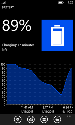

I have finally analyzed the battery usage today.
I used the device heavily with almost 2 hours of Real foot 2k13(my friends use my phone a lot :) ) , 30 mins on istunt 2 and other minor games , almost 2 hours total for email, wpcentral app, cricbuzz, phone calls, whatsapp, TOI and baconIt.
Here are the results I took the phone off charge at 100% at 9.50 AM and was down to approx 20% by 6.00 PM. My earlier stats were 7 -7.5 hours for the same drop, I see some increase in battery life (I can't say I have used the apps above for the same time before) but it can be said battery life has improved a bit, not very significantly.
For medium usage the results should be very visible.
