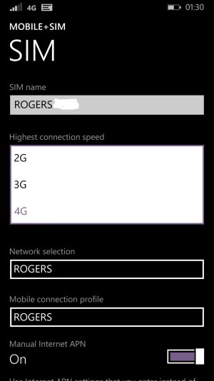

I am definitely in an area that has it (downtown), but still only see 4g. I have fiddled with my APNs (talked to Rogers, went online) but no luck. Still, no LTE.
I checked my SIM settings and the highest connection speed is set to 4G. Should I see LTE?

I tried searching as well and chose Rogers - nothing ever changed - still 4g. I am downtown
