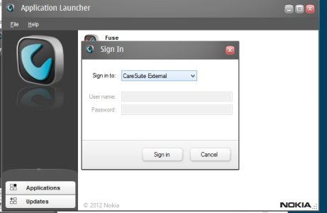

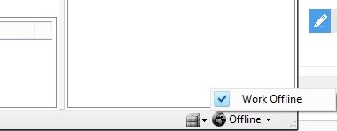

1. Download and install Nokia Care Suite (Don't launch Care Suite until step 2 is complete)
2. Extract usergroupsconfiguration.cfg to C:\Program Files\Nokia\Nokia Care Suite\Product Support Tool For Store 5.0 or C:\Program Files (x86)\Nokia\Nokia Care Suite\Product Support Tool For Store 5.0 for 64-bit (Be sure to overwrite)
3. Extract the firmware to it's location (Instructions are in the archive)

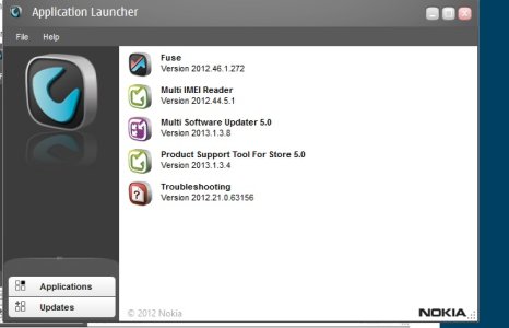

4. Open Nokia Care Suite
5. Double click Product Support Tool
6. Choose Caresuite External
EXTRA IMPORTANT STEP: Choose Work Offline on the bottom right of the window.

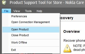

7. In Product Support Tool choose File > Open Product
8. In the filter box type RM-825
9. Your firmware should then appear in the box below if you put it in the correct folder on your PC.
10. Bite the bullet, hit START!

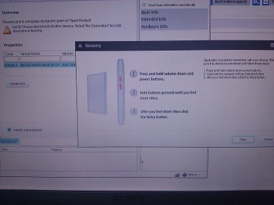

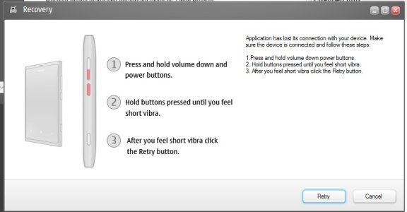

12. Once you hit start it will bring up the recovery screen saying it has lost connectivity, this is normal.
12. Turn your mobile off.
13. Once off, plug your mobile into your PC and hold the DOWN VOLUME key - because it was plugged into your PC it should power on automatically into the "RECOVERY" mode.
14. Hit retry in the recovery screen.

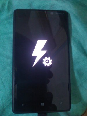

I've done everything mentioned in the post but it doesn't start flashing the phone. I'm currently on flashmode but nothing happens.
My system is Windows 8
it does recognize the device when I put it in flash mode
Can you tell me what step you got up to, what is on your phone screen and send me a screenshot of what's on your PC screen?
Thanks
thank you mate. those are the picture,
I think the problem is with the Bootmgr, I tried on another computer and I saw that Bootmgr failed to installed, device is unplugged.
I did install all the drivers from nokia care suite's driver folder but I still can't flash the phone.
When I plug the phone while it's off, the computer recognizes it but still can't flash.
If it's the bootmgr, where can I get the driver as I couldn't find it.
thanks

Ok, turn your phone on as normal (battery pull) then connect to your PC with a different USB port.
Then reboot it into recovery mode and see if that works.
Yes I did, nothing happens, still stuck at the flashmode

10. The software will check the package contents, it will fail to find the phone, and ask you to reboot and give you a button to click retry.
Phone Directions:
1. Plug the phone into your PC
2. Hold the Volume Down and the Power button, click RETRY on the Product Support Tools Window
3. After you feel a vibration in the phone immediately release the Volume Down and the Power button and hold the Volume up button.
4. Continue to hold the volume up button, you will see the software say "Rebooting"
5. After about 15 seconds you will see a top NOKIA logo and the software will start flashing the phone.
