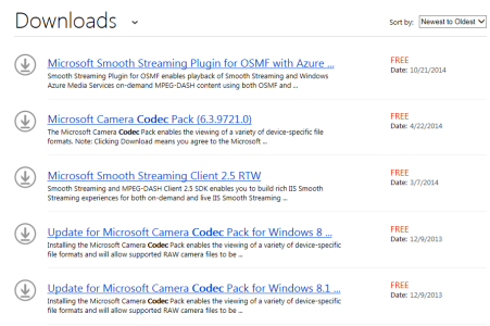

The first thing I did was look for latest MS Codec - I saw nothing specific for mp4 or 4K video. I'm well aware of what codecs are, and I appreciate your thoughts on this. I do try to stay away from the 3rd party drivers since this is for an enterprise environment. Searching for "Codec" at download.microsoft.com reveals nothing new since April of last year...
So - other than going 3rd party how is one supposed to support Windows Phone on a Windows supported OS?
