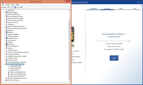

Hi all,
Was having the same issue as the OP, in that the I could transfer data between the phone and PC, but NSRT wasn't recognizing the phone. Here's what I did to fix my issue:
  • Uninstalled NSRT
  • Went to Device Manager, and uninstalled the "Universal Serial Bus Devices" for my phone (see image)
  • Reinstalled NSRT
  • NSRT now recognizes my phone
*For the Device Manager step, you may need to go to "View" and select "Show hidden devices." I right clicked and uninstalled each of those "Nokia Lumia 909 (RM-707)" files. As I uninstalled each one, it sometimes asked if I wanted to remove the associated software--I checked the box for yes. I didn't uninstall the "NOKIA BOOTMGR" or "NOKIA FLASH" files because I didn't know what they correlated with. The Nokia Lumia 909 files (there were three) reinstalled when I connected my phone.
Hope this helps.
