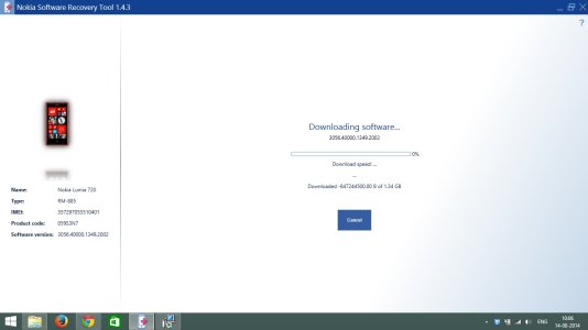

Hi, i have big battery drain with WP8.1 final, i want to downgrade to WP8.0 but i have a problem too with my lumia 520 : when the file is downloaded, Nokia software updater for retail (last version) and Nokia software recevery tools (last version too...) say :
3058.50000.1425.005 (RM-914) is corrupted, please download again.
I do it 10x...nothing to do...
Any idea , thx a lot !
I have tried this tool so many times and getting the same error "There is problem connecting to the service. Please check your firewall and virus protection settings and trying again". It shows up after downloading 500MB of data. Each time am getting this issue exactly at this point.
I had the same issue with Lumia 820.
The problem is with the firewall. The firewall does not allow the program to search for the OS on Nokia's servers. Disable it for the the recovery tool and you should be sorted.
After it finished downloading till 100%, it restarts the download again. I was like, what the ****? Need to wait 1 more hour to download?
