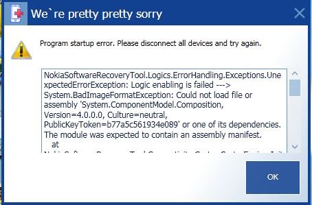

I've search the web and there's a quite a few comments regarding the 0x80131500 error showing up when trying to Flash your phone, but I haven't found any actual solutions to get around the error.
Briefly, I'm using a Lumia 1520 with DP8.1. Cyan has just arrived and I want to flash back to WP8 to get the full 8.1/Cyan OS.
But for two days now, I follow the Software Recovery Tool guide, the software downloads to the tool but the moment it starts the installation process I get the 0x80131500 error.
I've hard reset my phone...twice...no luck
I've unistalled/reinstalled the recovery tool....no change
I've even changed the usb cable I was using to tether the phone to the laptop...no luck
So, short of making a sacrifice to the software gods or chucking my phone against the wall, can anyone suggest a possible fix?

I was facing the same problem while restoring my Lumia1520 using the Nokia Software Recovery tool.
However, it seems your Windows firewall/Anti-virus program may be causing issues. My phone was restored successfully when I turned off both, the firewall and the antivirus program.
Give a try.

Thanks for your solution! This works for me!

I had the same problem, with a Lumia 520. I finally got it to install:
Download the Nokia Software Recovery Tool and install it, but do not run it.
Start MSCONFIG. Change the settings to Clean Boot.
On the General Tab, choose Selective Startup. Uncheck "Load startup items".
On the Services tab, check "Hide all Microsoft services".
Click on "Disable all" button, on the right side. Click OK button.
Restart the computer. You should now be able to finish the install.
Remember to reset MSCONFIG to Normal startup.
